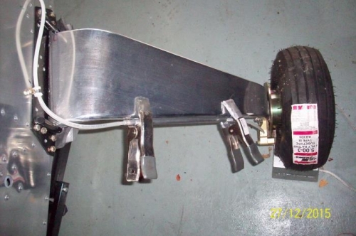

Next, I permanently attached the brake line mounts to the main gear using 3M Scotch Mount Automobile molding tape. I applied the tape to the two tabs on each mount then attached it to the underside/inside of each main gear and clamped them into place to set.

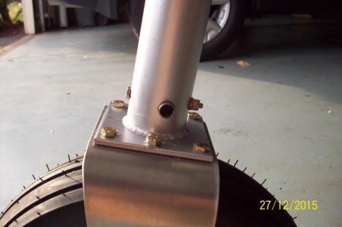

Lastly, I torqued the bolt running through the nose gear strut that secures the towbar attach tube in place - something I had neglected to do when I first installed it last summer.
Brake line mount clamped into position while molding tape cures.

Tow bar tube bolt now tighted to spec.
