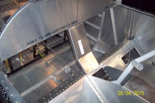

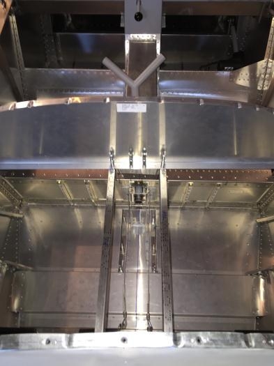

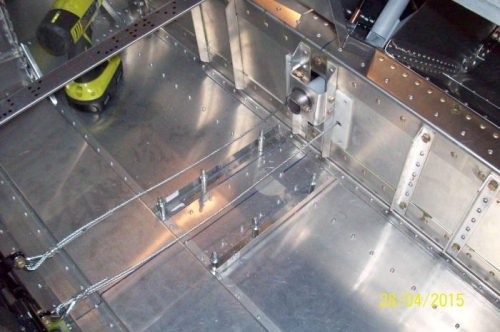

Put together the framework for the center console. Started by fabricating 2 L-angles that hold the bottom of the side panels in place. Once fabricated, I fit them into position and drilled them to the floor of the cabin.
Next, I pre-drilled the center console face (top and bottom) and the two upper L-angles in preparation for drilling them into position. I then drilled the console face into the wing spar frame at the bottom and the bottom flange of the instrument panel at the top, The two upper L-angles were drilled into the bottom of the instrument panel and the bottom of the firewall horizontal stiffener.
Two L-angles for attaching the bottom of the side panels.
Looking aft from above at the bottom and top L-angles and where they attach to the instrument panel.
The console face after drill out with the bottom L-angles on the floor in the background.
