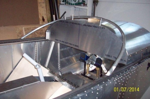

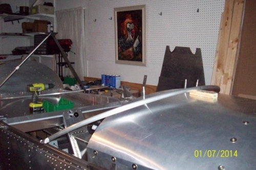

Next, I fit the forward canopy frame. The forward frame reinforces the canopy around the instrument panel and connects to the canopy side frames via gussets. Fitting the forward frame involved trimming the ends of the frame at a sharp angle so the frame and gusset fit flush against the side frames. I then employed my 2-blocks-of-wood canopy frame bender to shape the forward frame so that it lays flat on both side frames without any tension on it.

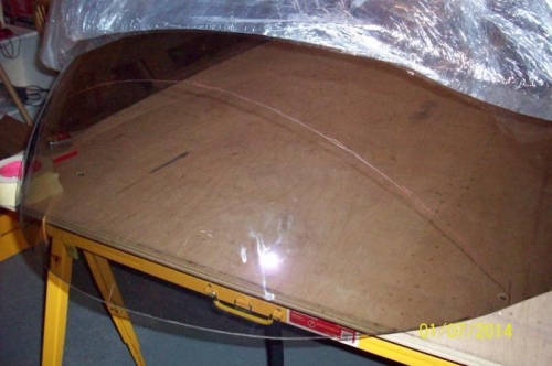

Lastly, I established all the corners of the canopy bubble in accordance with the photo assembly guides. Then I measured the centerline of the bubble. From there I measured out the first recommended cut which is to trim the aft end of the bubble as shown in image 3.
Forward side frame from the front raised off the top skin and instrument panel.
From behind - when installed it will only touch the bubble and side frames.
Aft end of canopy bubble with first cut line marked.
