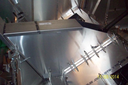

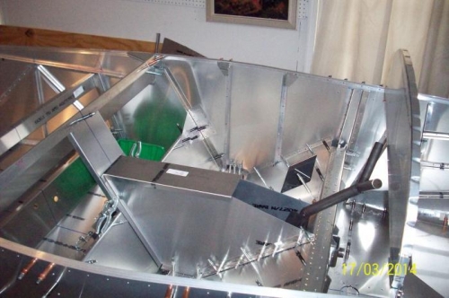

Began work on the center Arm Rest. Today's task was to get the two side panels to wedge in between the Center Spar in the front, the Seat Back in the aft, and the Gear Channel in the bottom. Once fit into place and clamped, I drilled out a couple of pilot holes to help hold it in place. Next I Match drilled the forward lower flanges on each arm rest to the seat angles previously attached to the inboard edges of the Front Seat Panels. Both sides are now fitted and the front portion (attached the the Front Seat Panel) is complete on both sides.
The Arm Rest taking shape between the two seats.
Close up from the passenger side.  Forward Seat Angle clearly seen.  Top is just for temporary fitting
