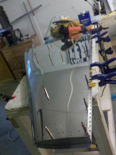

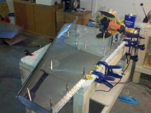

Brief Description:  Polish Stabilator
The Nuvite wool pads finally came in and work perfectly with my Harbor Freight rotary polishing tool. Applied more F9 to the top of the stabilator. Has a mirror like finish right now. Did 3 passes for each area I was working (meaning 3 applications of the polish). I worked it unitl all the polish was removed from the surface of the the metal. Looks pretty good for now.
