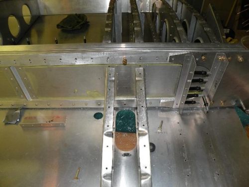

Brief Description:  wing mods
Finnished NR 2 bracing, drilled and cleco'ed. Was able to use my cheap transfer punches again... Bonus! Started removing the 2 lower solid rivets for rib braces on NR 3&4 will try to do this without removing the ribs. They have some solid flush rivets in skin that I would rather not remove if I dont have to. Picts provided. I am able to spread the braces enough to work between them so I think its going to work ok. Was getting to late to use the air hammer so will have to try to get those buggers out tomorrow.
Not much room to work

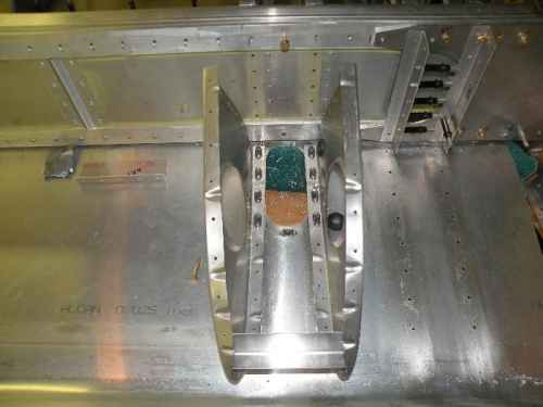

A ruined NR brace helps out!

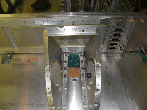

Trying to avoid removing flush rivets  in skin.  NR 2 is braced but not installed in this photo.
