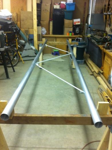

1. Cleaned spars
2. Dry lay out of spars and cross supports
3. Measure 17.75" spacing for ribs

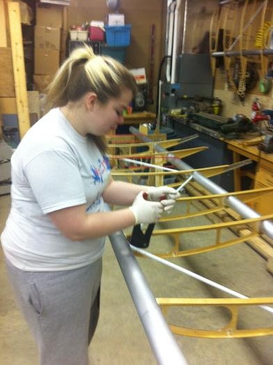

6. Glued cross braces, drilled out pilot holes, installed rivets

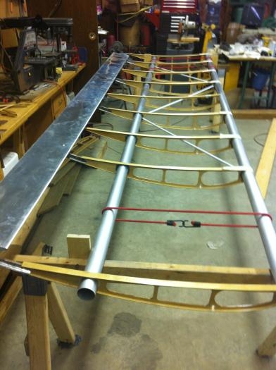

7. Glued ribs into place
8. Clecoed flaperon to ribs to confirm rib spacing
Dry Lay up of right wing
Pulling rivets in right wing
