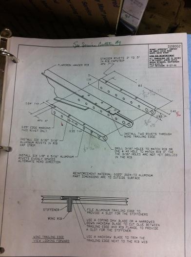

Rib Reinforcement Service Bulletin

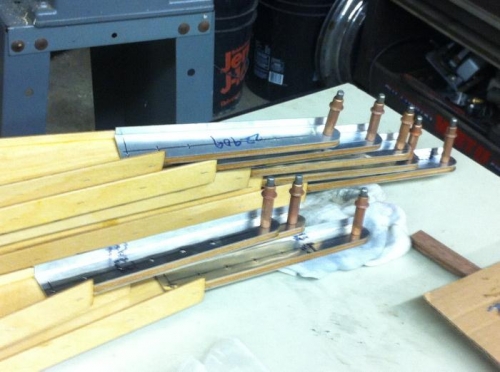

Clecoed Rib Reinforcements

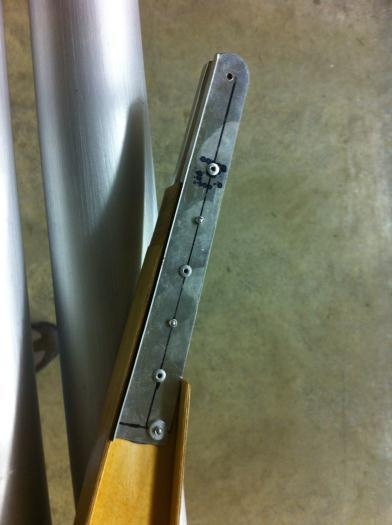

Finished Rib Reinforcement
