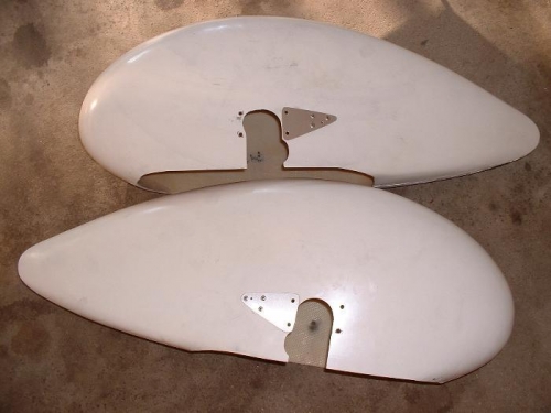

Added aluminum wear plates where landing gear fairing pin goes through wheel pant. Finished assembly of cargo net brackets and snaps. Finished assembly & adjustment of mixture control cable. Ran enging & worked to get good idle. Did not get acceptable idle. Ran engine approx 30 minutes.
Wear plates on wheel pants
