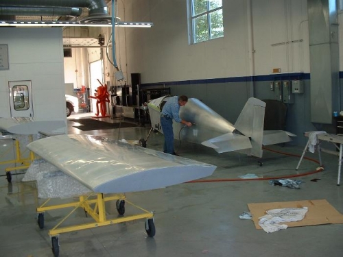

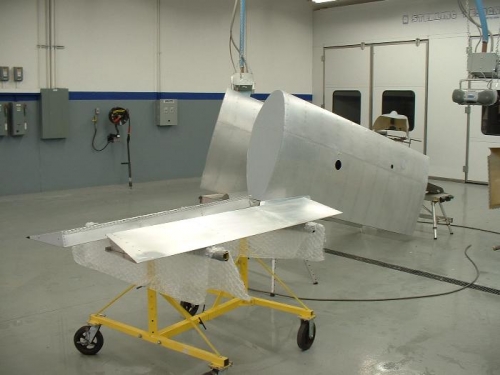

Degrease and acid etch prior to paint
Clean all of plane with wax & grease remover. Acid etch prior to paint. Rub acid with scotchbrite. Dry with towels. Blow every rivet dry with air.
Wings & fuselage etched
Wings & flaps etched
