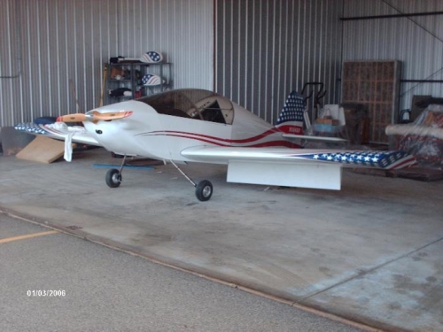

Rigging in process
Rigging in process

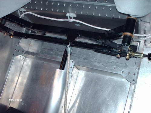

Control sticks rigged

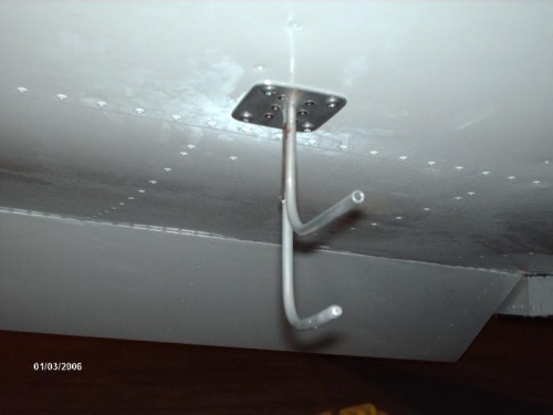

Pitot tubes in place
