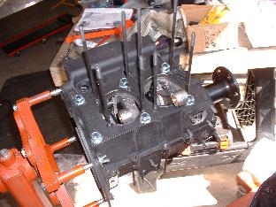

Continue Assembly
Make flywheel shim to get proper end play to allow for 3 main bearing shims. Verify cam/crank timing, check & grease bearings, & lifters. Apply sealer to case halves & assemble case. Install & torque all fasteners. Cam plug IS sealed.
Case halves after assembly
