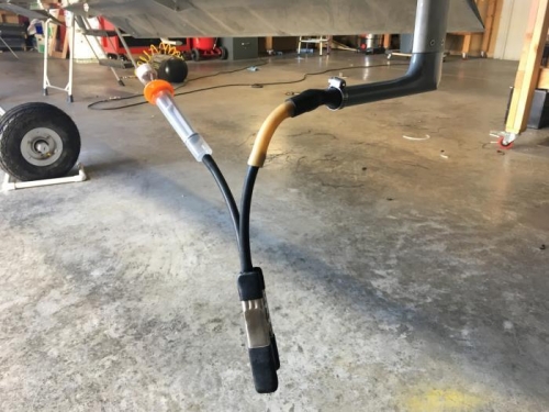

Replaced plastic tubes between ADAHRS units with 1/4 Al tubing. The push-on tee fitting in the static lines leaked. Got new tee from Lowes aviation aisle. With static ports sealed with two crossing lengths of 3M electrical tape, system didn't leak. For end-to-end test, took tape off the right static port and arranged a short length of rubber tube around the needle as a seal. (Image 1) Have to push hard to maintain a good seal. Results: 1450-->1410' in 1.5 minutes: 26.7 fpm. PASS.

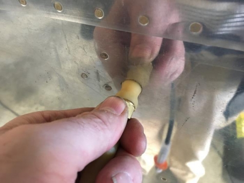

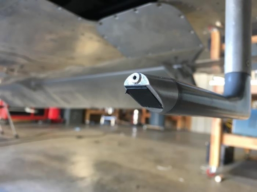

For pitot, I covered the AOA port with 2 pcs electrical tape (Image 2) and arranged a larger ID rubber tube to seal the tip of the pitot and the base of the needle (Image 3). Results: 213->212 kts in 1.5 min: 0.7 kts/min. PASS.
If AOA port is not sealed, leak rate is about 2x the spec for the pitot alone (20 kts/min), There being no specific spec for the AOA line's leak rate so far as I know, I'm leaving it as is.

Making a seal on the static port
AOA port covered
AOA port covered
Needle in the pitot sealed by outer black rubber tube.
