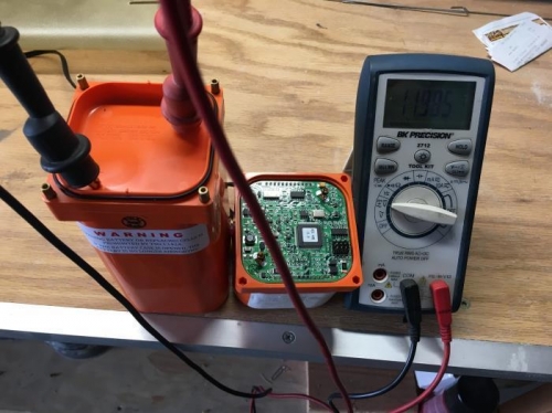

Before putting rear baggage bulkhead covers back on, took out the ELT and checked electronics and battery posts for corrosion--none found. Battery voltage 11.985 V, whatever that's worth knowing (Image 1). Armed the unit and gave it's g-switch a "snap" test while listening to 121.5. It activated and I turned off the switch. Reinstalled unit and will run the self-test (activated from the panel control) tomorrow. Ship's power is off for this test so I dug out the Icom AC-23 handheld. I don't think the NMH battery will take a charge after so many years; bought some AA alkalines for the alternate power pack.

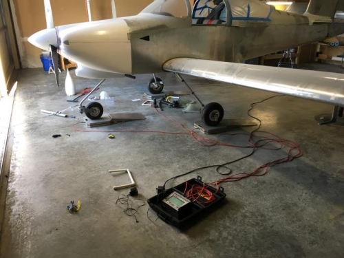

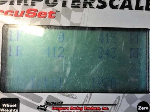

It was getting late, so I winched the plane up on the scales (Image 2). The no-gear fairings empty weight was--ta da--1070 lb (Image 3), but the fuse wasn't leveled so the per-wheel weights are bogus.
The ELT's pristine electronics
748PK on the scales
748PK on the scales
Pantsless empty weight 1070 lb
