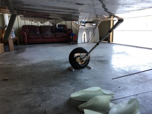

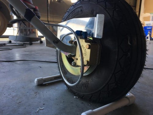

To fit the main wheel pants, have to install the new brackets I got from Vans several years ago to replace the ones that got bent up from pant legs catching on them in the garage. Will need a better way to jack up the wheels than a hose clamp around some silicone tape down low. The tape crept and allowed the clamp to scrape a bit on the powder coat under load on the floor jack. Well, go the new brackets on and all nuts and bolts torqued to spec. THEN I read in the directions the gap between the brake disk and bracket must be 0.032-0.094. I have to measure the gap and turn down the spacers! At least one more cycle of wheels on and off in the near future. :(
Left inside bracket
Left inside bracket
Right inside bracket
