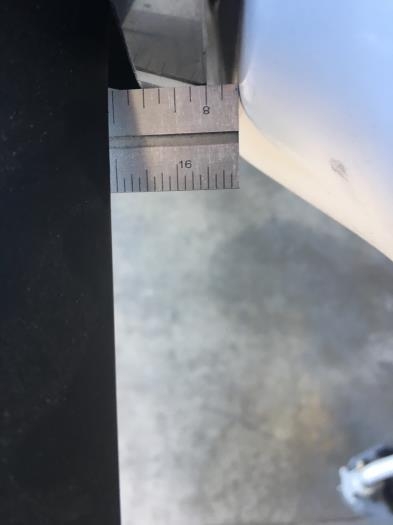

-- Rough sanded the micro fill on the wheel pants' seams. Drilled #40 and clecoed IAW plans locations. (Image 1).

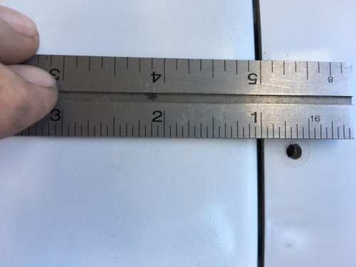

-- Images 2 and 3 quantify the spinner-cowl gaposis. Fairly even 1/4" gap on the bottom cowl--can fix with sanding. Need to take the top cowling down 3/16" at it's narrowest gap (which is too close to run, I think, not just ugly). I'm thinking about slicing off the "ring" and reattaching, preserving the existing rounded edge. Taking the ring down with agressive sanding probably thins thins fiberglass too much. Oh well...besides the main wheel pants, this is the last major piece of glass work to do.
Clecoed wheel pant halves
Spinner-cowl gap: Too close!
Spinner-cowl gap: Uneven!
