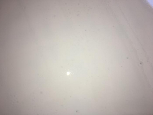

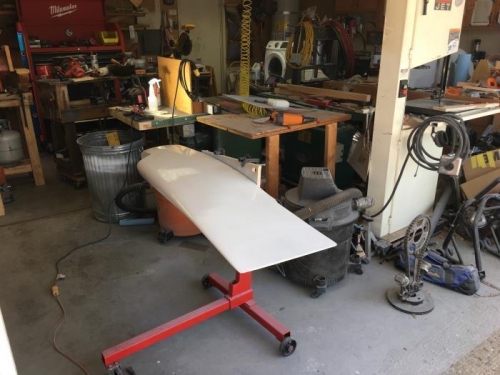

--Painted wingtips w/hi-build primer. Rigged up Karl's engine stand to paint horizontally. (Image 1). Wet sanding (squirting water from a spritz bottle) is evidently source of mucho fisheye. DRY SAND ONLY. The rattle can spit out TON of sandpaper-rough goobers on the frontside of the first tip as well. Will need to redo this wingtip. The other one (dry sanded) is acceptably ugly..

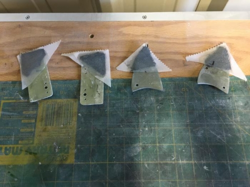

--Added 1 layer carbon and 2 layers 9 oz cloth to cowling cut-out covers.
The rig worked well; not so the finish.

Fisheye for the queer fly

Build up shallow areas of cowling cut-out covers
