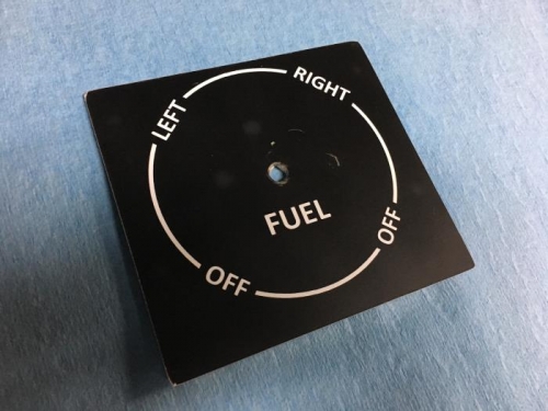

Brief Description:  Fuel selector placard; new fuel lines
Printed up a placard for the fuel selector: black ink on white photopaper. Sprayed 3M 77 on the plate the fuel valve attaches to, then placed on the face-down print to adhere. Did 4 coats of Krylon matte finish to protect...but not before a couple scrapes, as seen in image 1. It's good enough! The two faint spots to the left and upward from the valve stem hole are bolt holes for the valve, not yet opened up. There are holes around the plate perimeter for 8-32 screws that will be opened when the time comes.
