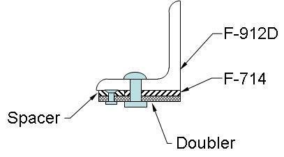

Fabricated F-912D, the up-elevator stop from Al angle. Drilled #30 holes in the stop down the center of the angle, aligned it to the end of the aft deck and match drilled. Turns out the opening for the elevator horns didn't extend to the edge of the angle, so the edge distance of the holes in the F-714 deck wasn't up to snuff. Cut a spacer to fill in the missing F-714 from 032 Alclad, and attached it to an 032 doubler, then riveted F-912D to F-714 to Doubler as shown in Image 1.

Up elevator stop x-section
