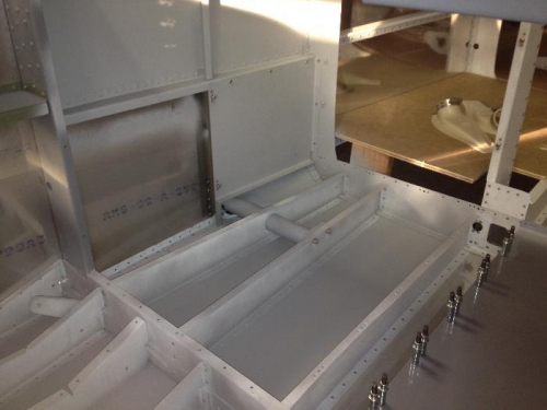

Prepped and primed baggage area side covers and tie-down nutplates. Riveted the tie-down nutplates to the fwd baggage side covers. Installed nutplates on the fwd covers; ran a tap thru these nutplates because the screw is quite close to the wall--plans say to do this to make installation/removal tractable.

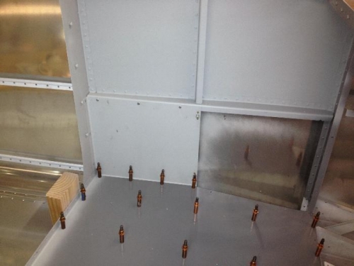

Primed the inside of the F-970 skins in the baggage area where the covers won't go. Also primed the bottom skins on the inside where the baggage area floors and seat pans will be permanently attached with pulled rivets. Will be leaving "accessible" Alclad that doesn't show unprimed--don't need to add the weight!
Installed the rear side covers on both sides, then the baggage area floor on the pilot side.
Right baggage area
Right baggage area

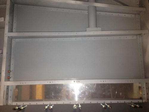

Overhead shot.  Tunnel floor unprimed--it is inspectable.
Left side baggage area--floor ready to rivet.
