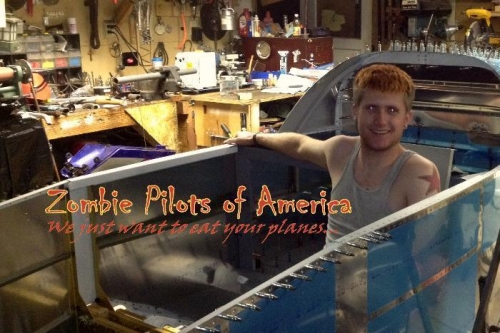

Yours truly, first butt in the fuse, Image 1.

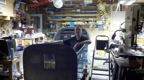

No. 2 son, no. 2 butt. Image 2 and 3.
