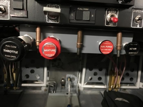

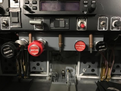

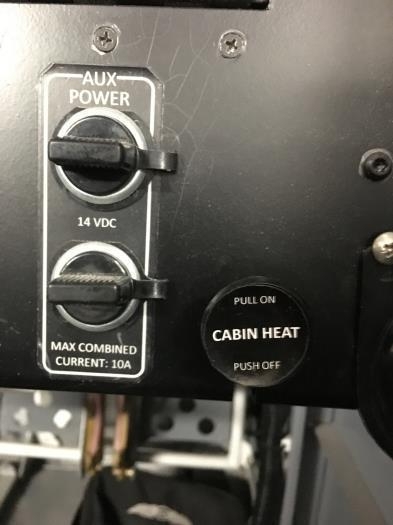

Brief Description:  Final cockpit placards; misc finish items
Hours for President's day w/e accounted for in previous entry,
Attached placards to throttle, mixture, purge, alt air, and cabin heat controls with 3M 77 spray. Not shown in pictures: applied placards for the glare shield lights and replaced the passenger warning (which was peeling off!) with new wording the FAA has recently mandated.
