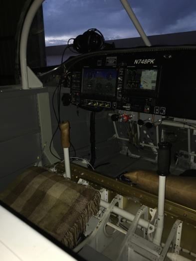

With the flaps and ailerons rigged, was able to "box the sticks" and determing how much to cut them down so the top of the grip doesn't interfere with the throttle/mixture/purge/alt air controls. The pilot stick had to include room for a thumb covering the (unpressed) PTT switch at the top of the stick. The copilot removeable stick has no buttons on it, but I made it as long as the pilot stick and there's room for a thumb atop its grip as well.
I was able to immobilize the pilot stick between my legs and gently apply a dremel cut-off wheel (carbon fiber gritted wheel for metal) while holding a shop vac hose in close proximity to pick up most of the swarf. A ring of blue painters tape made the cutline very visible, but I first cut 1/4" shy to make sure. Copilot stick was a comparative cinch as it could be detached and cut on the bench.

Pilot and copilot stick lengths set.
