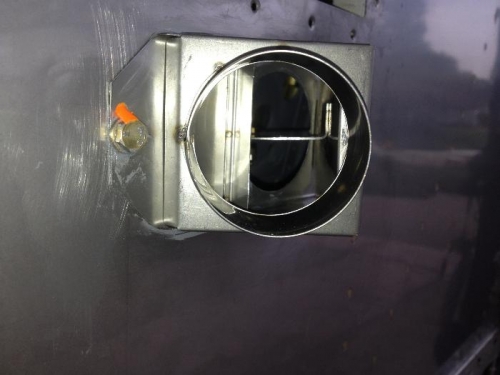

Install cbn heat cntl box; laminated Cu bus bar
Installed the heater box. I used nutplates on the cabin side of the f/w. Biotherm sealant applied to the faying surfaces around the hole.

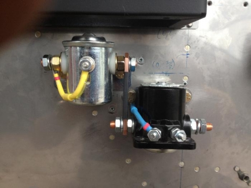

Fabricated a Cu buss bar for the master/starter contactor connection. Used 5 layers of 0.025" Cu sheet, sweat soldered together.

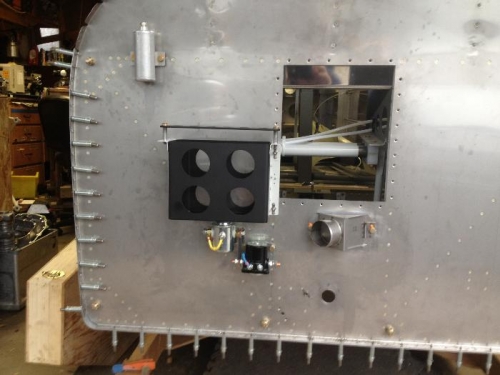

Populating the firewall...
Master contactor/starter relay
Looking into cabin heat control box
