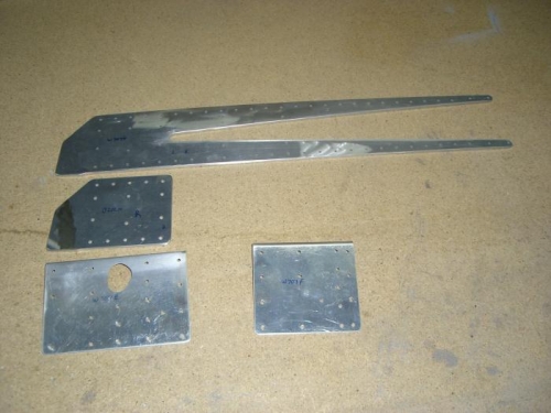

Deburred the right and left rear spar reinforcement fork.
Deburred the right and left rear spar doubler plate.
Trimmed the right and left spar reinforcement forks and doubler plate.
Drilled the right and left spar end reinforcement plates.
Drilled the right and left spar center reinforcement plates.
Cut out the holes for the aileron pushrods in the center spar center reinforcement plates.

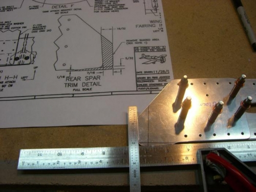

Marking the area to trim on reinforcement fork.
Started trimming.
Started trimming.
All parts drilled and deburred
