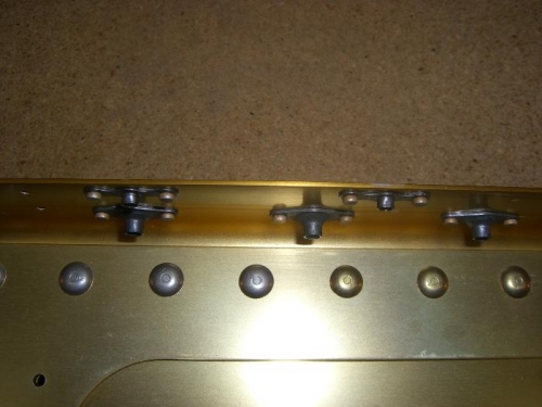

Installed the platenuts that attach fuel tanks.
Installed the platenuts that attach access plates.

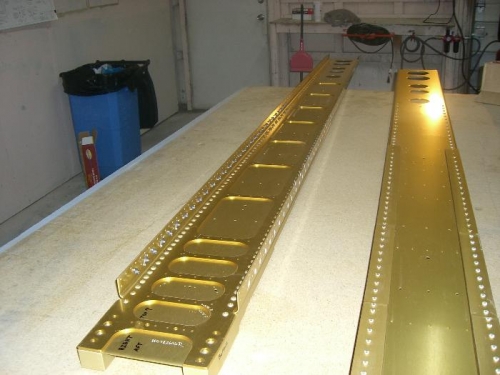

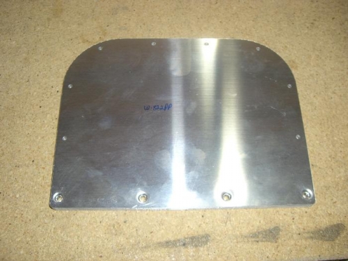

Dimpled the access plates that attach to the spar.
Countersunk the spar flange for the access plate dimples.
Spot painted all the countersunk holes.
