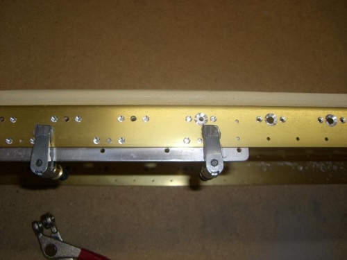

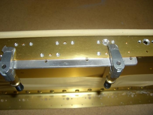

Countersunk screw holes for fuel tank. I used an aluminum stock with a #30 hole as a guide to keep the countersink round and smooth.
Fuel tank attach screw countersunk.
