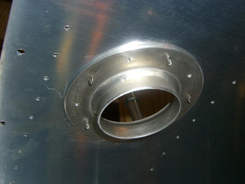

Drilled hole for vent line elbow in left and right tank rib.
Fit and drilled the T-406B fuel cap flange for left and right fuel tank.
Dimpled the skin for the fuel cap flange rivets.
Countersunk the top of the T-406B fuel cap flange for left and right fuel tank.
Deburred the T-406B fuel cap flange and skin for the left and right fuel tank.
Fit and drilled the VA-112 drain flange to the left and right fuel tank.
Deburred the VA-112 drain flange for left and right fuel tank.
Deburred the skin for the drain flange attach rivets.
Made T-714 vent line clip that attached to the fuel cap flange for left and right tank.
Deburred all rivet holes on the left skin.
Left fuel tank flange.
Left fuel cap
Left fuel cap
