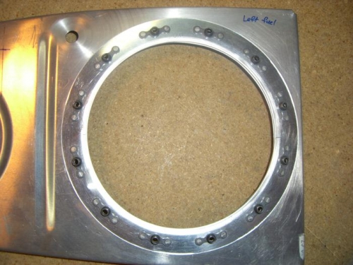

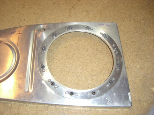

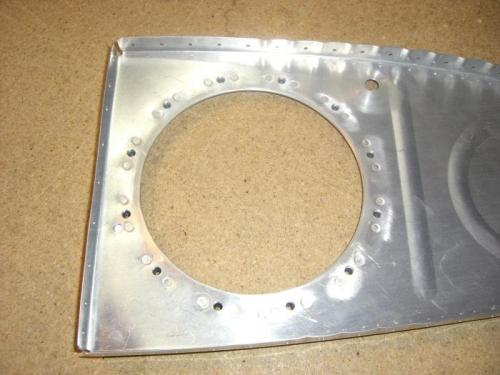

Deburred all holes on the stiffener, access plate and rib. Left and right
Countersunk the stiffener.
Dimpled the ribs.
Deburred the access cover plate.
Riveted the stiffener and the plate nuts to the ribs. Left and right.
