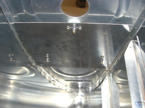

Drill the T-813 Fuel Sender Plate to the most inboard interior tank rib. Left wing.
Installed the 3 nut plates.
Modified the snap bushings to allow the fuel sensor wire installation.

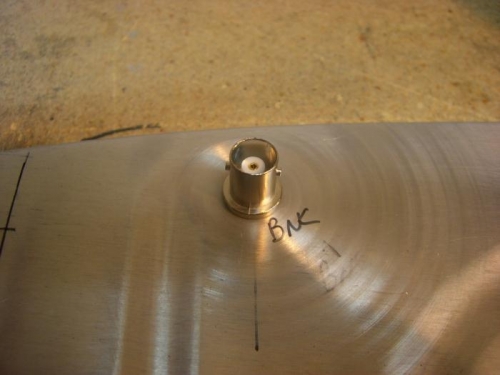

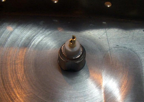

Drill a hole in the inboard tank rib for the bulkhead BNC connector. Left and Right.
Inboard Fuel Sender Plate
BNC Connector
BNC Connector
BNC Connector
BNC Connector
