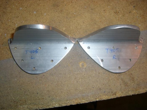

Fabricatde the right T-405 tank attach angle and pre driled with the rivet holes.
Pre drilled the rivet holes in the left T-405 tank attach angle.

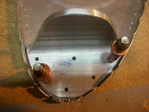

Matched drilled the left and right T-405 to the rib and T-410 reinforcing plates.

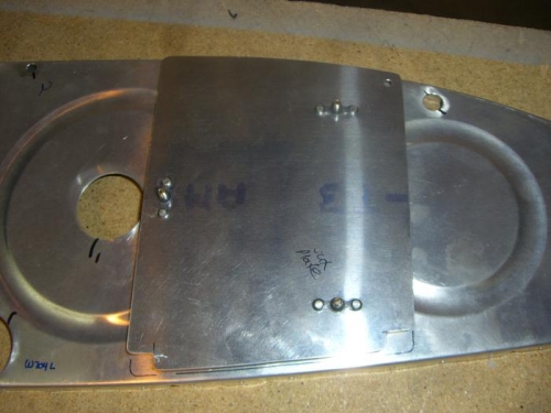

Drilled one T-813 Fuel Sender Plates to the most outboard internal tank rib.
Installed the 3 nut plates.
Cut the corners of the T-813 to make clearance for the fuel tank stiffeners.
Left and right T-405
Left T405 on rib
Left T405 on rib
Left fuel sender plate
