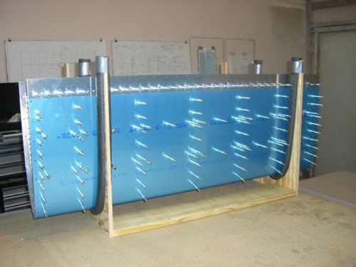

Brief Description:  Wing, Left fuel tank
Removed the left tank assembly from the wing, and drilled all rivet holes to final size.
Countersunk the holes in the skin that attach to the baffle.
Drill the spar attachment screw holes and the W-423 screw holes to final size.
Fabricated the T-405 tank attach angle less drilling the attach holes.
