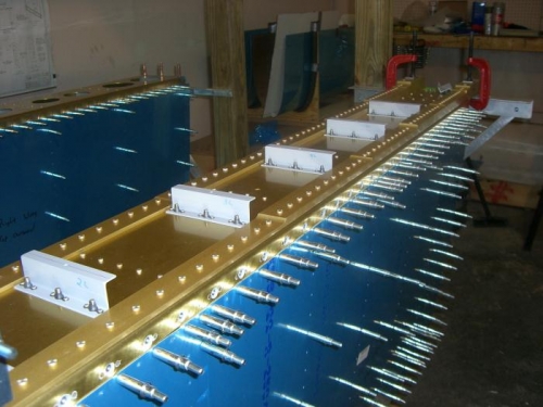

Drilled the nutplates to the attach angles.
Countersunk the attach angles for the nutplates.
Primed the attach angles.
Riveted the nutplates to the attach angles
Bolted the attach angles to the spars.
Clecoed the fuel tank baffles to the attach angles.
Nutplates and attach angles

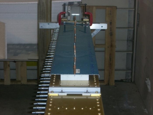

Angles attached to the spar
Tank baffle clecoed on
