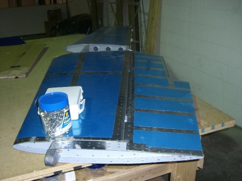

Installed left elevator.

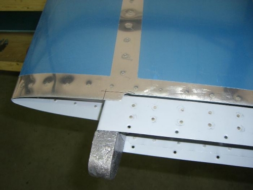

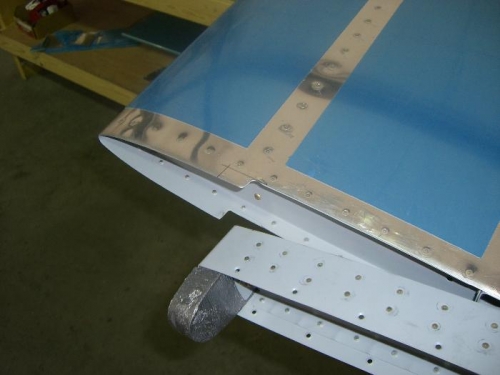

Trimmed horizontal stab skin for clearance of the elevator counter weight.
Trimmed the horizontal stab spar to allow for clearance of the elevator control horn.
Verified 35 degree up and 25 degree down movement.
Left Elevator Installed
Trimmed Skin
Bottom trimmed top is not trimmed
