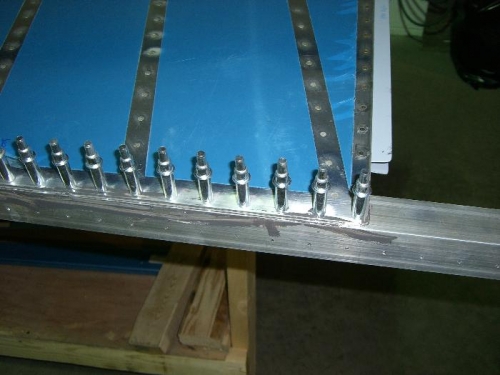

Bonded the trailing edge with pro-seal to prepare for riveting and clecoed it to an aluminum angle to keep straight before riveting

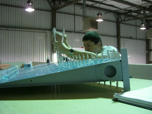

riveting the skins to the spar.

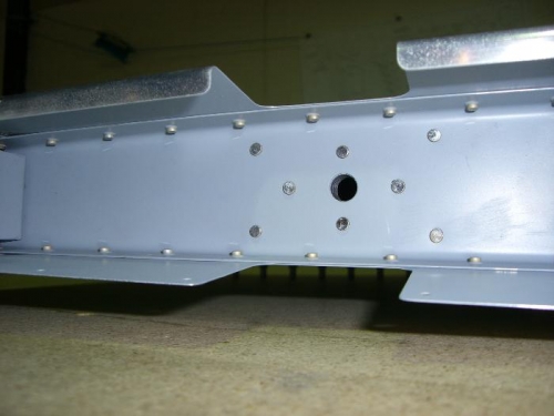

Sking and Spar rivets.
Trailing edge bonded with angle to keep straight.
