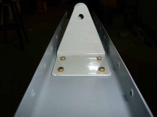

Brief Description:  Riveting the Horizontal Stabilizer
Mike and I started riveting the left horizontal stabilizer together. We did have to change the rivet length when riveting the HS-412PP and HS-413PP hinge brackets to the rear spar. The plans called for a an470ad 4-5 but they were to long, we used an470ad 4-4. We also changed the length of the rivets from an470ad 4-6 to an470ad 4-5 when riveting the HS710 and HS714 to the front spars.
Rivet Length changed.

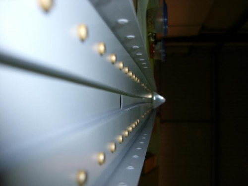

Good Rivets.
Good Rivets.
HS404 and Front Spar
