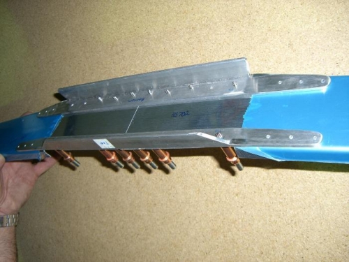

Completed all steps of front spar assembly chapter 6 page 1-2.

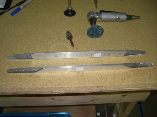

Matched drilled the front spar and the front spar reinforcement angles. Tapered the ends of the front spar reinforcement angles. Trimmed the inboard tabs of the front spars so that they could be bent to proper angle. Bent the front spars and front spars reinforcement angles to 6 degrees.
Tapered the ends of the front spar angles
Front spar
Front spar
front spar
front spar
