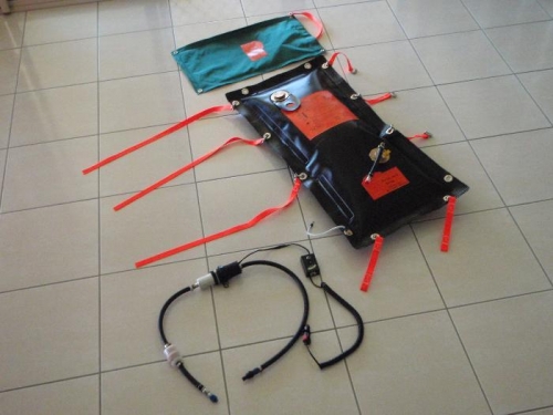

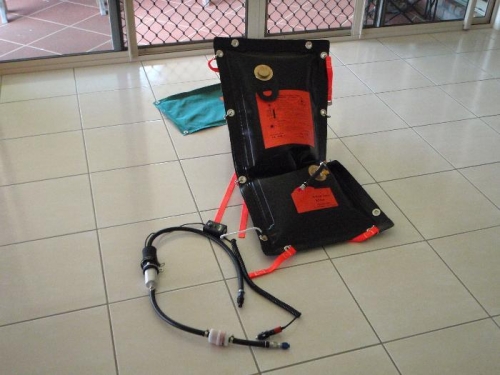

Brief Description:  Turtle Pac Aux fuel system
Below pictures of the Turtle Pac Little Buddy,40 ltr aux tank and associated plumbing.Plumbing to the aircraft consists of a 12 volt Holly inline fuel pump,filter assy,fused cigerette lighter adapter,and coulpes to airframe with a quick disconnect -6 Jiffy Tite dry break fuel coupling.Additionally I have wired the installation thru the aircrafts electrical system with the addition of a 5 Amp circuit breaker on the panel.Ground trials conducted and all systems functioned great.Air tests carried out and fuel transfer completed in less than 10 minutes leaving only a dribble of fuel in the Turtle Pac.
Installation of the tank after filling takes less than 5 minutes and less to remove the system.
With the 912ULS this will increase the aircrafts range by well over 2 hours.
After use the entire installation can be removed and carried on board in a small bag,total weight for the empty unit is about 10 Lbs and full 73Lbs.No special tools except a phillips screw driver required for fitting to the aircraft.
*** Turtl Pac can be contacted on Australias Gold Coast on ..61 7 55981959.........
Operating procedure...
** Strobe light OFF
**Fuel valve from BOTH to FWD
**OPEN tap on Turtle pac
**Switch transfer pump ON.........
ON COMPLETION OF TRANSFER
**Switch transfer pump OFF
**CLOSE tap on Turtle Pac
**Fuel valve from FWD to BOTH
**Strobe light ON.........
The Turtle Pac is a non vented tank so no provions for venting required and no saftey concerns as it does not feed the engine directly.........instead adds fuel to the wing tanks only.
