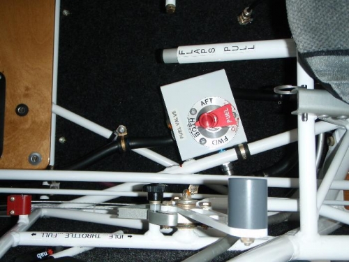

Brief Description:  Provisions for auxillary fuel tank
This is the first part of a auxillary fuel system.The kit suplied fuel valve has been removed and replaced with a 3 way Andair fuel valve.In doing this I am able to isolate the fwd tank feeds from the rear tank feeds,thereby feeding the engine from the front tank feeds only ( during transfer ) and at the same time pump aux fuel back up into the main tanks via the rear fuel feed lines.Once transfer is complete ( 40 lts ) the valve will be repositioned back to the "BOTH" position.This tank assembly comes with a inline fuel filter, 12 volt pump and switching.The idea is to plumb it into the fuel line some where below the back seat.
Andair fuel valve installation

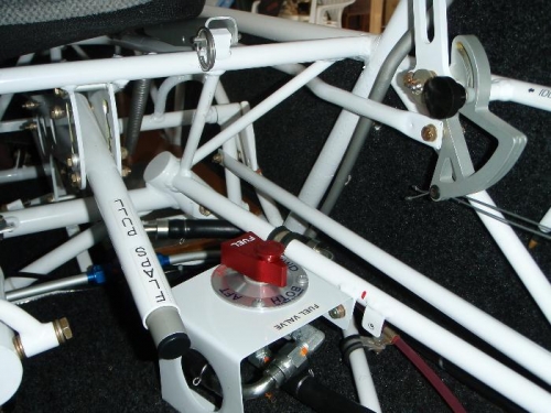

Installed valve and plumbing

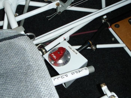

Top view of installation
