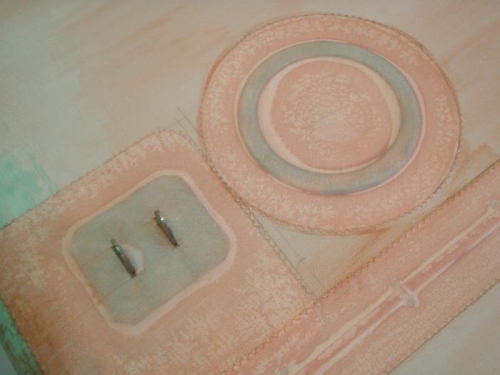

Brief Description:  L/H wing reinforcements..continued

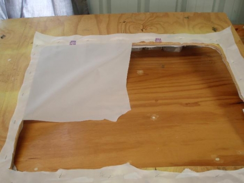

27 th and 28 th of November..lower surface reinforcement tapes,gussets and doileys and access hole reinforcements.prepare leading edge plastic bolt cover cap.Will install after the initial L/E 4" tape.Photo number 2 is of the peice of ply I have cut out and simply staple the un shrunk fabric to it ,then use the iron to pre shink at 250*...then makes it easy to mark out and cut all your reinforcements out.Its a dogs life................Stormo
A couple of the reinforcments
pre shrunk fabric on shrinking frame
