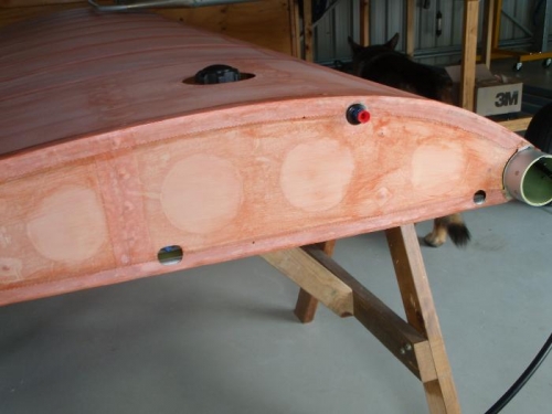

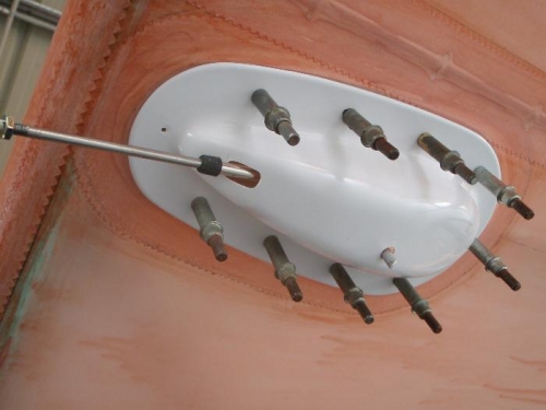

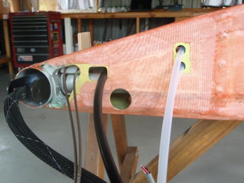

Final taping of inboard end of wing,note picture #2 shows modified aft rib plate to better accomodate fuel line routing.Flap teleflex and Aileron exit fairings trimmed and drilled off into position.Final check over all fabric and tape work, wing pretty well ready for further Poly Brush,Poly Spray and top coat of Aerothane.
Inboard end of wing covered
Modified rib rear plate for fuel hose exit
Exit fairings drilled off and trimmed
