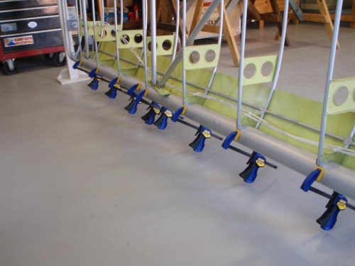

Brief Description:  R/H wing build up.....
Prepare spar tube and leading edge strip for bonding,clean all and tape off area.Apply 3M DP460 adhesive to faying surfaces and apply clamps and clamping board.Clean excess glue from job........

Adhesive clamped and setting up
3M  DP460 Adhesive
3M DP460 Adhesive
