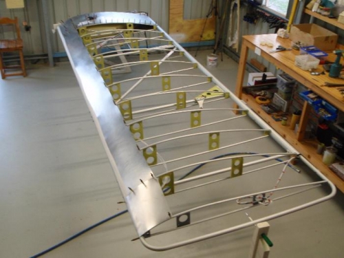

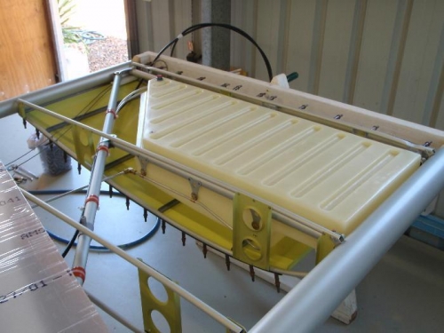

Brief Description:  Sheetmetal work L/H wing
Set out and installation of leading edge wrap,leading edge wrap stiffener tubes cut to length and positioned and drilled to ribs with gusset plates,all deburred and rivetted into position.Prepare lower fuel tank skin and drill off to wing ,all deburred drain doubler installed,acid wash and paint internal skin,ready for reinstallation with rivets and double sided tape.Scuff leading edge spar tube for bonding.
L/E stiffener tubes and gussets
L/E wrap installed,ready for bonding
Preparation of lower skin.
