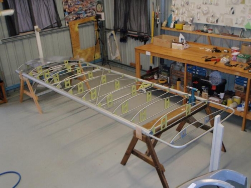

Brief Description:  Installation of wing ribs
Today I started to install the wing ribs.Firstly the spars were dimensionally set out with the rib locations then I started to rivet the ribs in position.I put a smear of adhesive under the forward and rear spar clips prior to rivetting.I havent yet tackled the fuel tank top skin but just wanted to check the rib spacing prior to rietting in the first and second ribs in place......More tomorrow
3/4 's done
3/4 's done

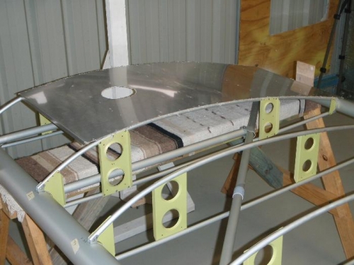

Checking spacing between ribs 1 and 2 and the top skin

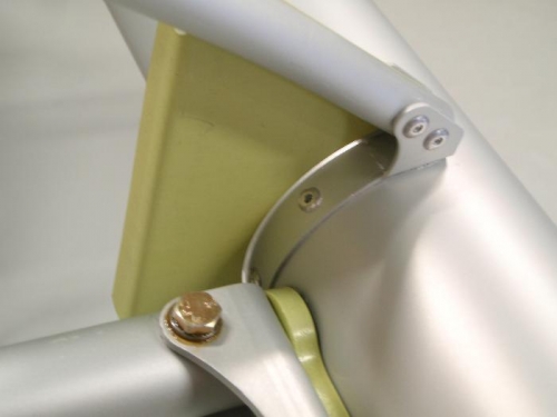

Forward spar clip rivetted in place
