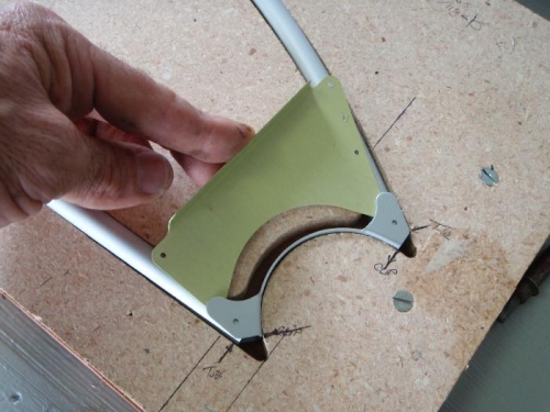

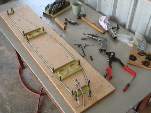

Well its off to work we go.....New Guinea,well I took a punt annd took all the components with me,a quite tour allowed plenty of time to build my ribs and kept my sanity.Rudy one of the mechanics helped out.During preparation all the sheet metal was etched and alodined and primed up.At assembly all the gussets were asembled with proseal prior to rivetting.
Fitting nose gusset
Fitting nose gusset
Assembly underway
Assembly underway
