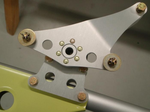

Brief Description:  Aileron bellcranks / Install in wing

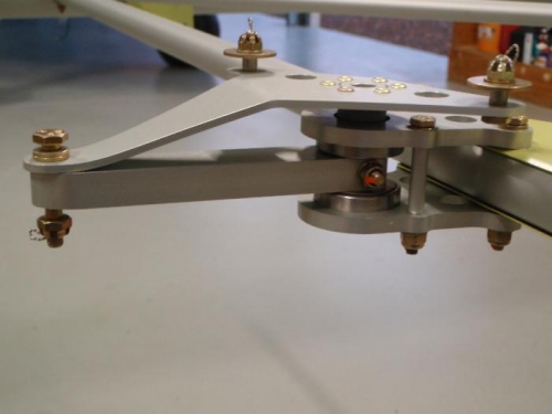

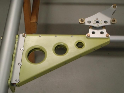

Install bearings into mount plates,Rivet plate to spindle,I replaced the called up pop rivets here and used AN470 solid rivets,all components assembled and spindle shaft drilled for attach bolt.Unit offered up to brace tube and drilled off,attach hardware installed,with the two AN3-20A bolts that go only thru the two plates,I also installed a spacer bush between the plates,this helped tension the assembly correctly without putting a pinch on bearings and causing stiffness.
Side view of assembly,note spacer bushes
Plan view,replaced pop rivetys with AN470 solids
All complete
All complete
