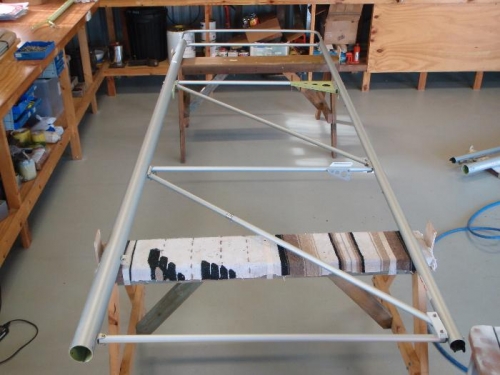

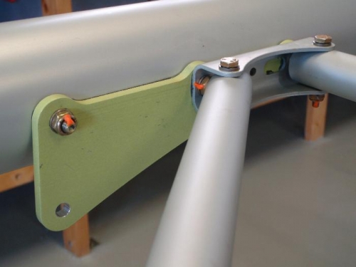

Brief Description:  Build up Fwd and rear spars / Assy R/H wing
Build up two rear spar and two forward spar tubes,drill all holes and install all doubler plates,paint all bare aluminium metal with 30Y94 primer,Recontour,bush and Install rear spar attach bracket,Build up R/H wing frame,all strut attach plates,doublers and aileron gusset plates assembled with proseal PR1422 and rivetted in place,frame now ready for ribs.
R/H wing frame assy
R/H wing frame assy
Aileron bellcrank gusset
