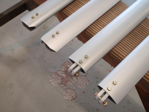

Brief Description:  Jury strut components
Prepare all strut material,ream and install all aluminum blocks and clevises per manual,bolt together lower gusset plates and installation of stainless rivets..plates installed with wet PR1422 proseal and all fittings and blocks assembled with Mastinox anti corrosive protection,struts now ready for installation on A/C
End fittings bolted and rivetted in place
fittings all bolted together

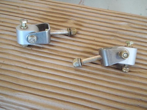

Rear spar attach cube and U bracket ready for installation
