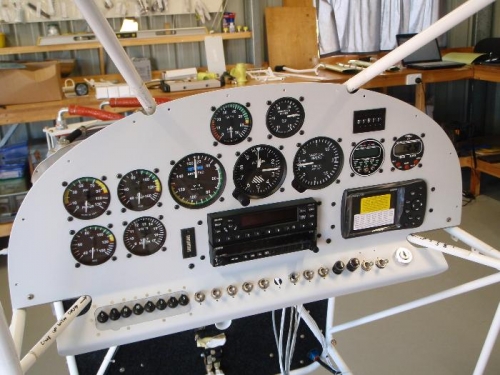

Installation of instrument panel after painting,install all instruments and final alignment and fitting of radio racks.Had planned on two adjacent rows of circuit breakers ......but an oversight and clearance become an issue.Dual row removed and single row installed,involved being real careful not to interfer with the finish,cutting out the existing and installing a flush inlayed panel to house the breakers....all good the engraved overlay will cover the inlay .All left now is to wire it ......stay tuned.UMA 2 1/4" instruments used ,much nicer appearance than the VDO supplied equipment.EI fuel flow gauge,Garmin GTX327 Txpdr,Garmin SL40 VHF,Garmin 296 GPS
all minstrumentation installed awaiting engraved panel to overlay switching/circuit breaker panel

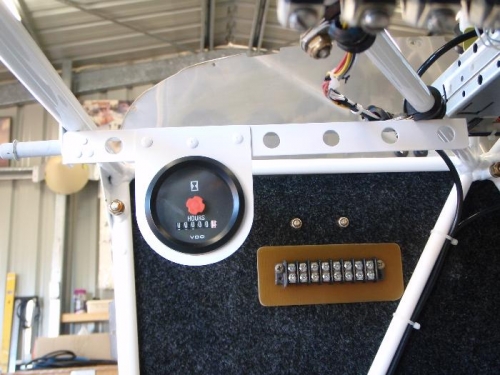

hour meter ,bracket manufactured and mounted just forward of dash panel

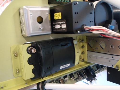

Garmin 296 installation ,back mmounted and retaining brackets installed
