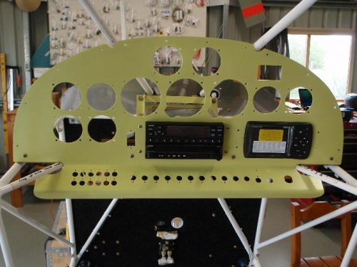

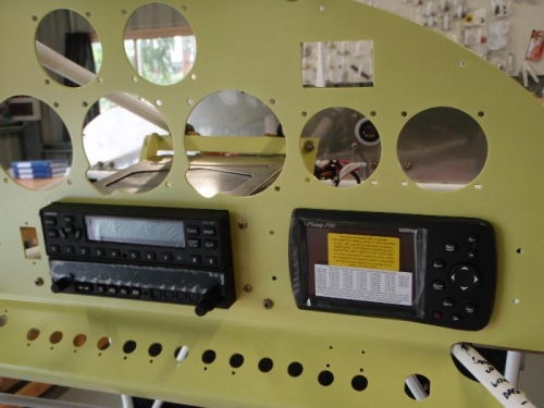

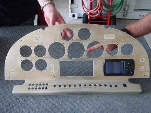

Brief Description:  Modified dash board
Manufacture modified dash panel to go together with Joel Millaways glare sheild..New panel 2024-T3 .063 material,acid washed and alodine ready for paint.Using UMA 2 1/4" Engine instruments,ASI,ALT,VSI,Electronics International Fuel Flow instrument,clock.
Garmin SL40,Garmin GTX327 Txpdr,Garmin 296 GPS.Replaced rocker s/w's with all toggle MS type s/w's.Final holes yet to be placed for control cables,carb heat ect....Initial trial fit to airframe and final adjustment.Prime panel with AWLGRIP 30-Y-94 primer in readiness for AWLGRIP 2000 flat Whisper grey top coat
modified dash board
modified dash board
initial trial fit to airframe
30-Y-94 AWLGRIP primer
